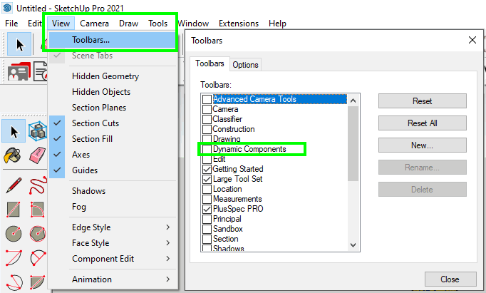

Ensure Dynamic components are turned on. You can do this by opening your extensions manager, then toggling the Enabled button for PlusSpec, on and off. If you have SketchUp 16, you can do this by un-ticking and ticking PlusSpec.
In SketchUp go to View > Toolbars > and ensure Dynamic Components are checked.
