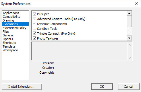

For SketchUp Versions 16 and Below
It is also possible that PlusSpec has not been installed correctly. To check this, open SketchUp, then click Window/SketchUp > Preferences > Extensions. Amongst this drop-down list on the page, PlusSpec should be visible and ticked. If PlusSpec is not ticked, please tick it.
If PlusSpec is not visible, you will need to re-install PlusSpec. Click Here to go to the PlusSpec downloads page.

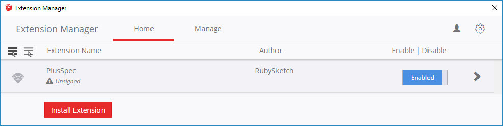

For SketchUp Versions 17 and Above
It is also possible that PlusSpec has not been installed correctly. To check this, open SketchUp, then click Window/SketchUp > Extension manager. Amongst this list on the page, PlusSpec should be visible and enabled. If PlusSpec is not enabled, please tick it.
**If PlusSpec is not visible, you will need to re-install PlusSpec. Click Here to go to the PlusSpec downloads page.
