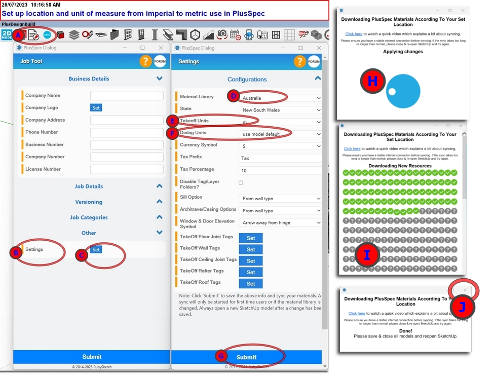

PlusSpec is able to use metric and imperial as units of measurement.
In changing the settings of your preferred standard unit of measure, go to Settings Tool. (see image below)
You can also adjust this when you scroll down to the bottom of the job tool and click settings. After you've chosen your unit settings, click submit.
Currently, only Australia, UK, and USA are available in the setup.
