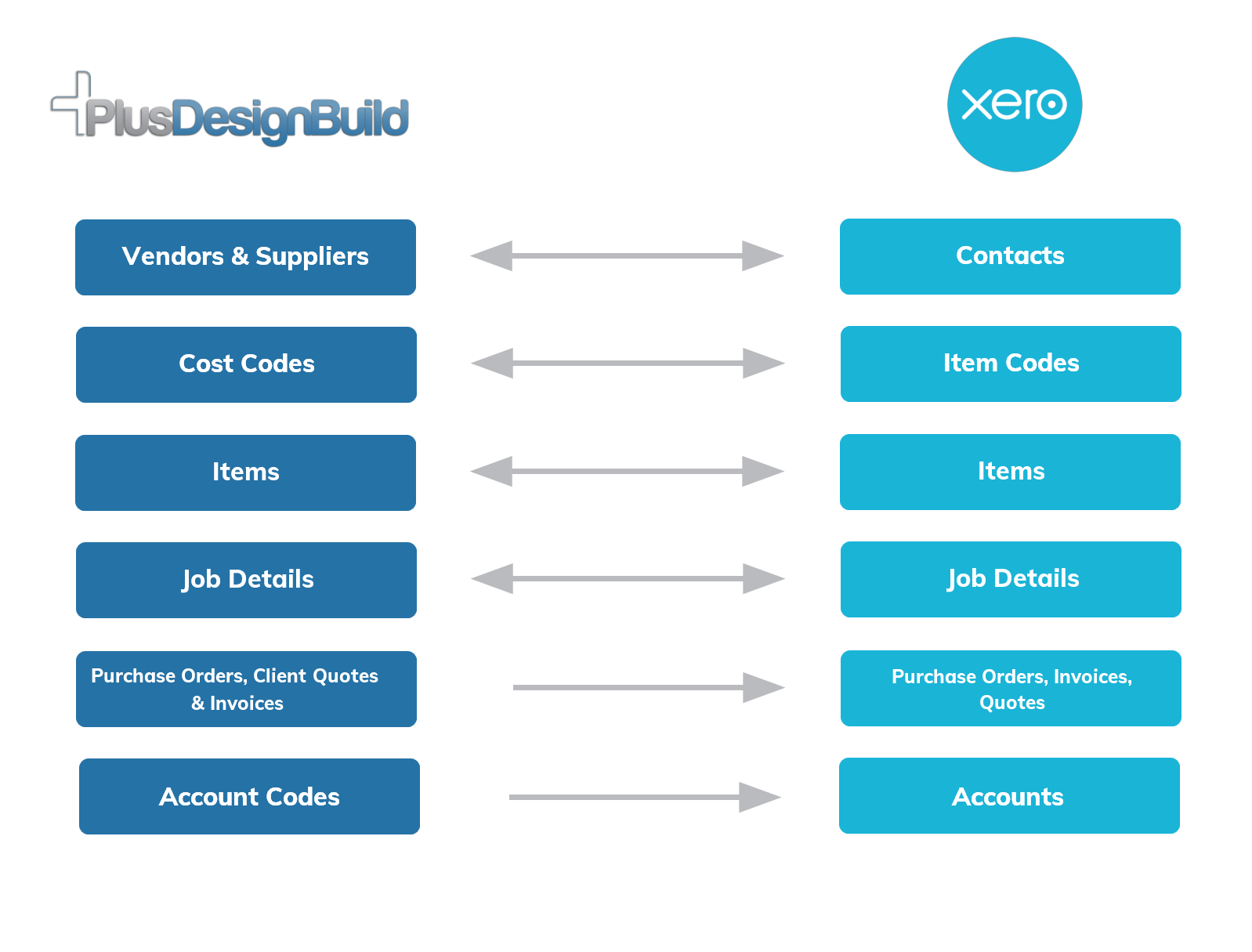

Data Flow

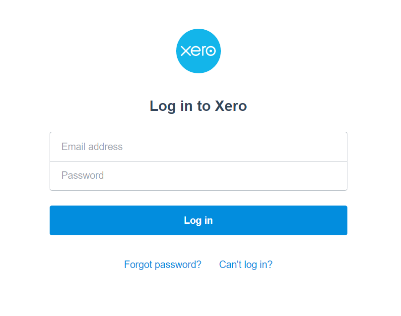

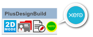

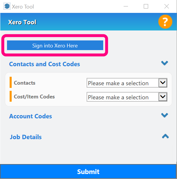

1. Click on the Xero Icon on the PlusDesignBuild Toolbar
2. Next, click on the 'Sign in to Xero Here' Button in the Xero Tool Dialog

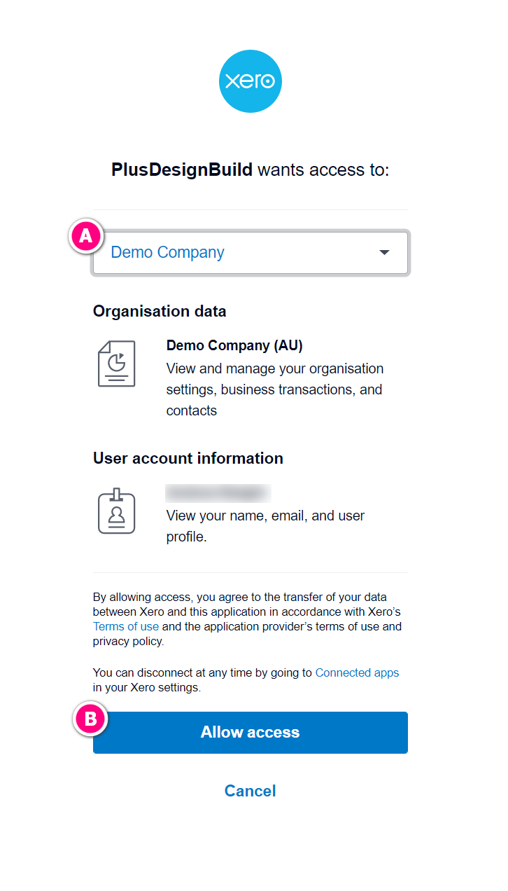

3. Log in with your Xero Credentials
4. Choose your Organisation and Click 'Allow Access', then Return to PlusDesignBuild inside of SketchUp

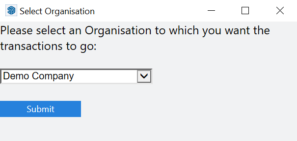

For each model you use Xero with, you will be asked to choose the organisation you would like the transactions you are doing (a transaction being any PlusDesignBuild to Xero process) to go to.
This prompt will only pop up once on the first transaction you make each time you open a model.
Simply select the organisation you would like the transactions for that model to go to, click submit and repeat the previous transaction.

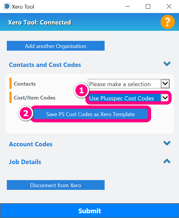

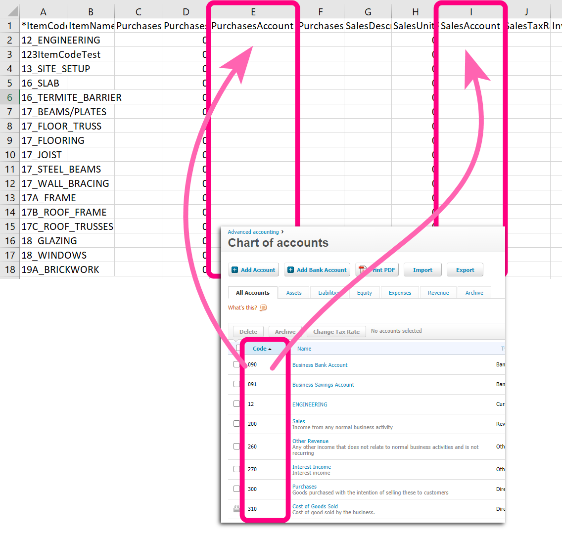

1. Continuing on after logging in (see above steps), click on the Cost/Item Codes Drop down (Under Contacts and Cost Codes), and choose to 'Use PlusSpec Cost Codes' [1] then Click 'Save PS Cost Codes as Xero Template' [2]
This will save a .csv file that will later be imported into Xero. (NOTE: please do not change the name or format of the file.)
2. Open the .csv file and add the relevant Account Code under both the 'PurchasesAccount' column (E) and the 'SalesAccount' column (I) according to the ItemCode in column A.
The Account Code, usually a number, can be found under Accounting > Chart of Accounts inside of Xero. Only insert the code into the PurchaseAccount and SalesAccounts columns.
Ensure you do not change or move the headings in Row 1.
Once you are happy you have added in the applicable Account Codes to the Cost Codes, save the .csv

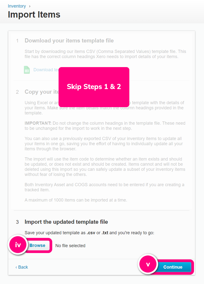

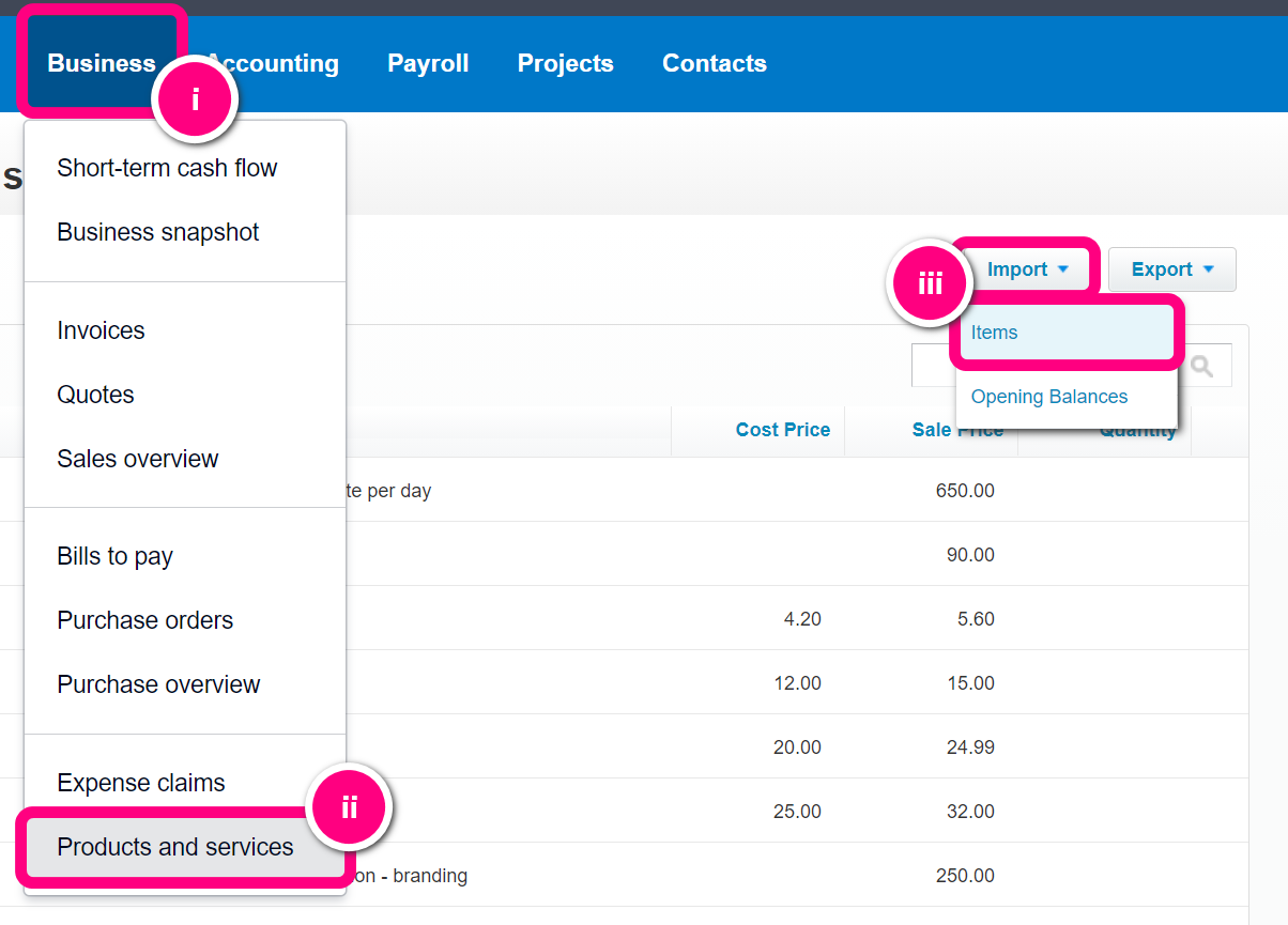

3. To import the file into Xero, head to your Xero Dashboard, Go Business > Products and Services> Click the Import Button > Items.
4. Jump to Step 3 and click 'Browse'. Choose the 'PS Cost Codes.csv' file you exported from PlusDesignBuild and click Continue
5. Click Continue to finish

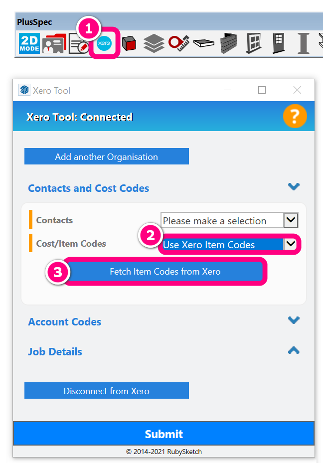

6. Head back to PlusDesignBuild, Open the Xero Tool and Select the 'Use Xero Item codes' from the Cost/Item Codes dropdown. Click the 'Fetch Item Codes from Xero' button and your Cost Codes and Accounts will be connected.

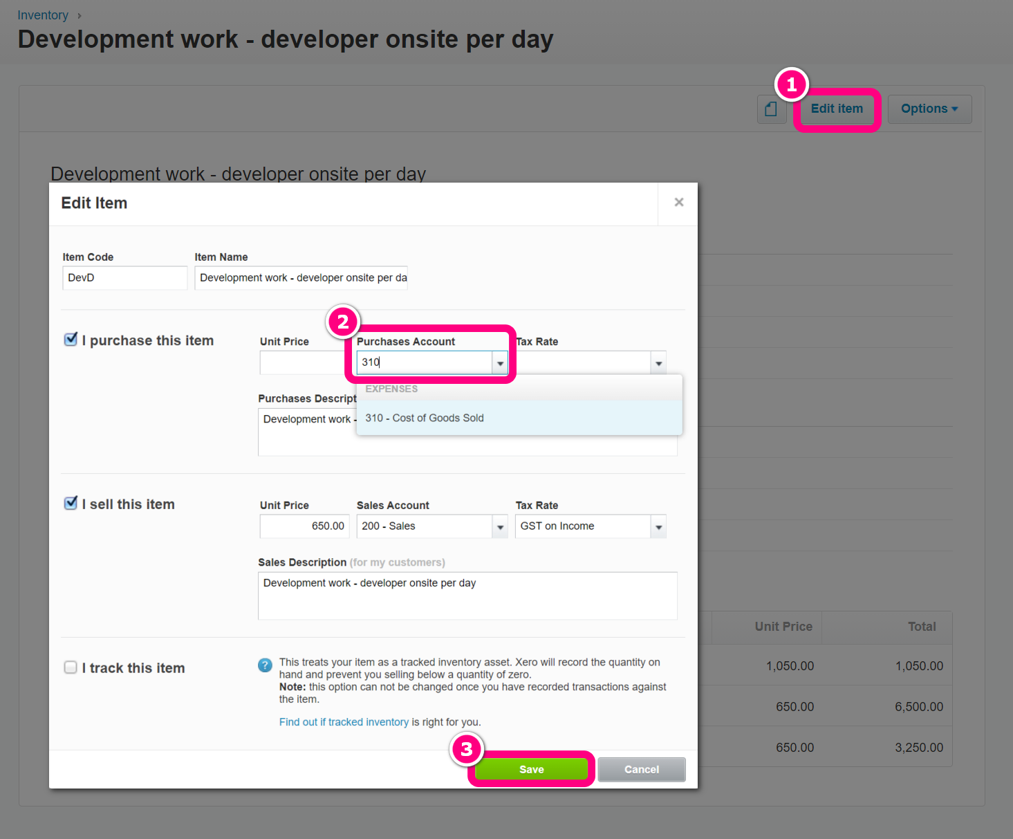

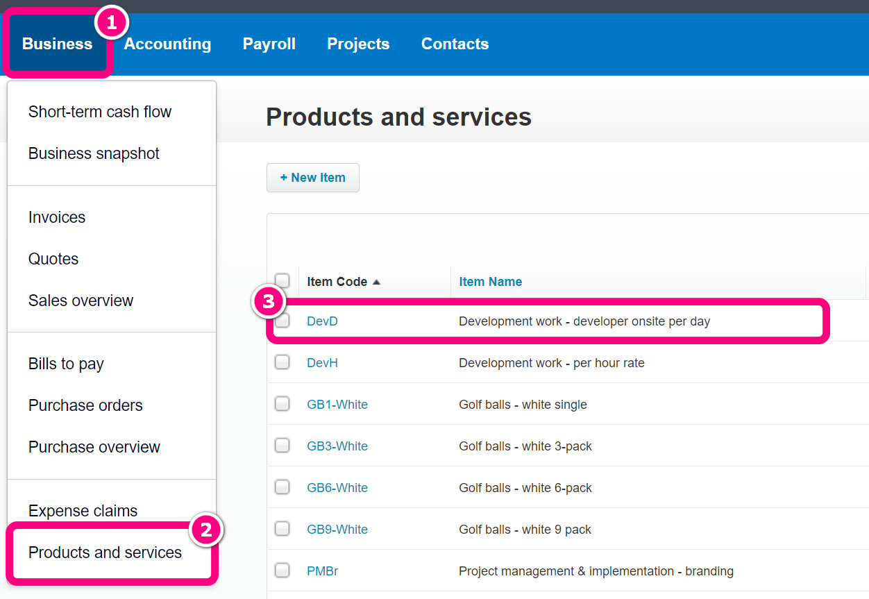

Option B:
1. Go to your Xero Dashboard > Business > Products and Services and Click on the Cost Code you'd like to associate an account to.
2. Click Edit Item, Select a Purchases and/or Sales account and the Click Save

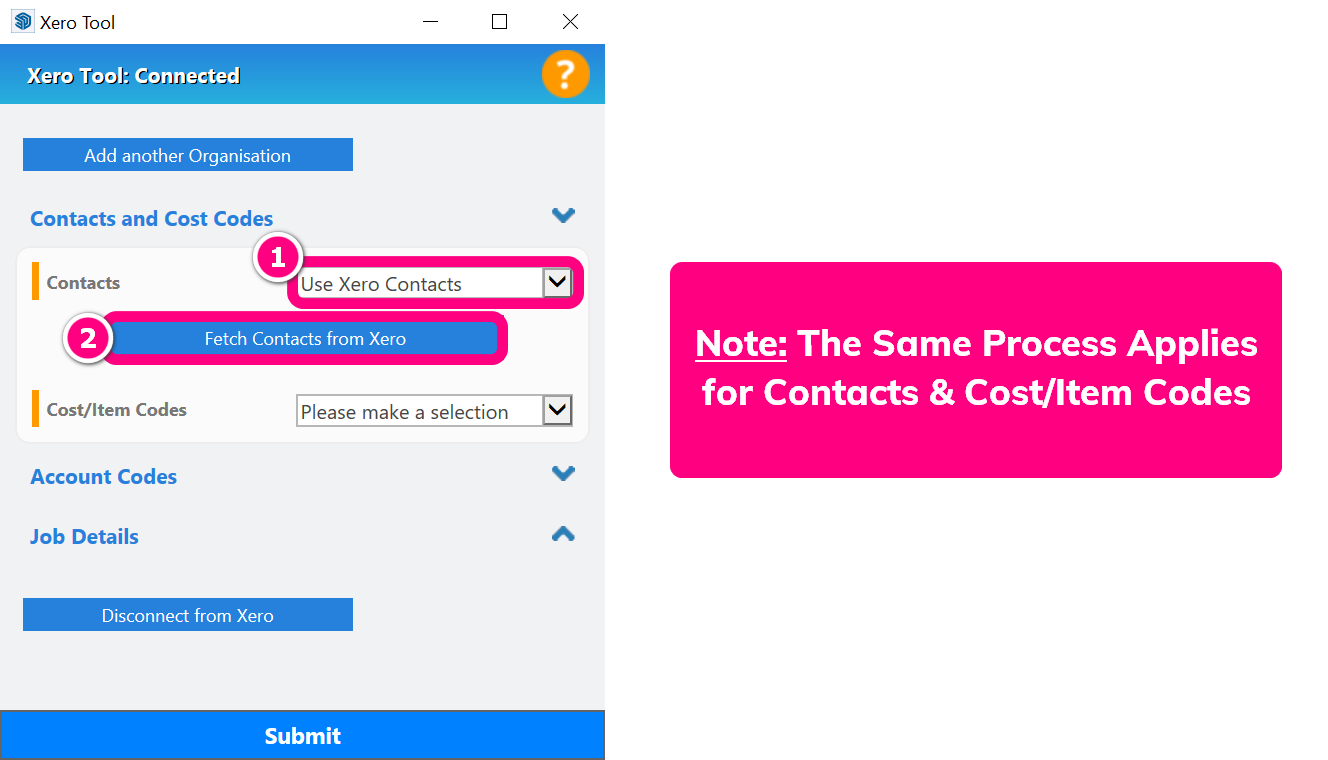

1. Once you have returned to PlusDesignBuild, ensure you have the Contacts and Cost Codes drop-down open, then make selections according to whether you'd like to import your Contacts or Cost/Item Codes from Xero into PlusDesignBuild or vice versa.
For Existing Xero Users
a) To import Contacts or Cost/Item Codes from Xero into PlusDesignBuild, simply click the 'Use Xero Contacts' or 'Use Xero Cost/Item Codes' dropdown option respectively [1] and then click the blue 'Fetch (Contacts/ Cost/Item Codes) from Xero' button [2].**

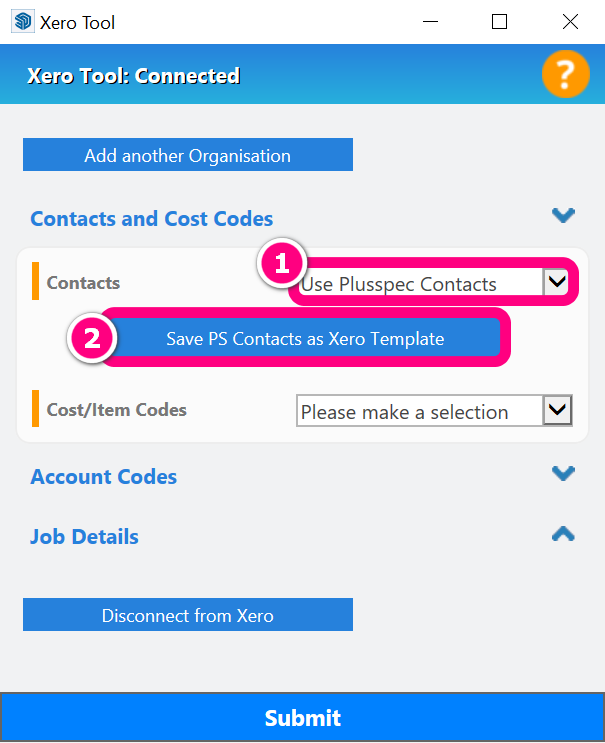

b) To import Contacts or Cost/Item Codes from PlusDesignBuild into Xero, simply click the 'Use PlusSpec Contacts' or 'Use PlusSpec Cost/Item Codes' dropdown option respectively [1] and then click the blue 'Save PS (Contacts/ Cost/Item Codes) as Xero Template [2]. **
This will save a .csv file that can be imported into Xero. (NOTE: please do not change the name or format of the file.)

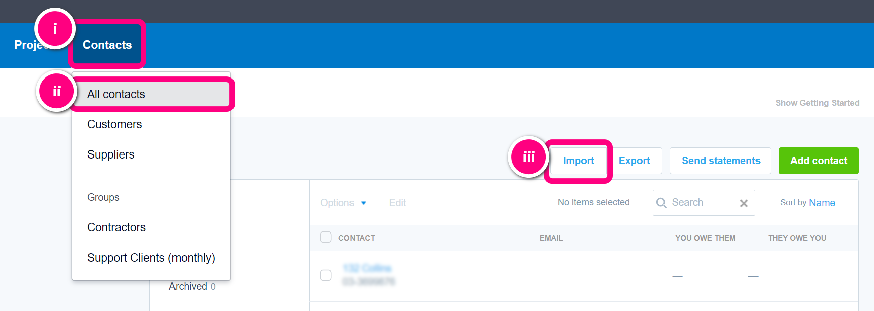

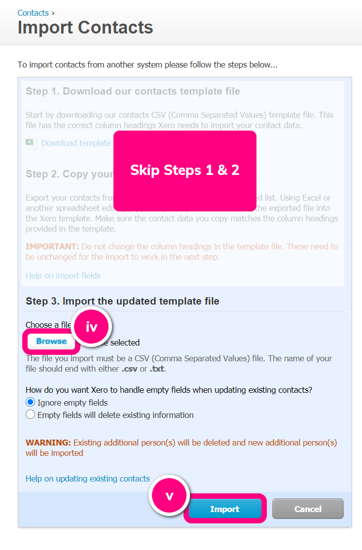

To Import CONTACTS into Xero from PlusDesignBuild:
i. Open your Xero Dashboard
ii. Go Contacts > All Contacts
iii. Click the Import Button
iv. Jump to Step 3 and click 'Browse'. Choose the 'PS Contacts.csv' file you exported from PlusDesignBuild
v. Click Import
ii. Go Business > Products and Services
iii. Click the Import Button > Items
iv. Jump to Step 3 and click 'Browse'. Choose the 'PS Cost Codes.csv' file you exported from PlusDesignBuild

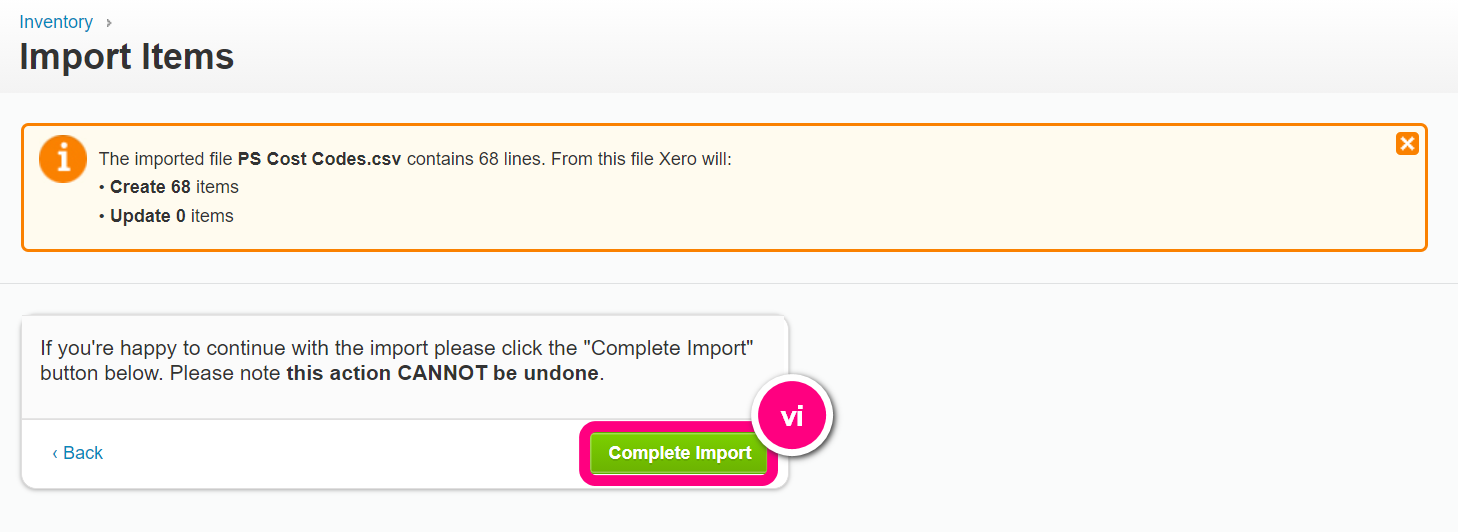

v. Click Continue
vi. If you're happy with the import click Continue

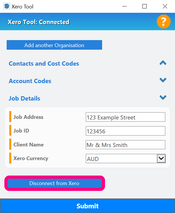

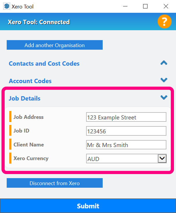

1. Ensure the 'Job Details' Drop down is open. Add in a Job Address, Job ID, Client Name and choose your Xero Currency. You need to add Job Details each time you create a brand new model

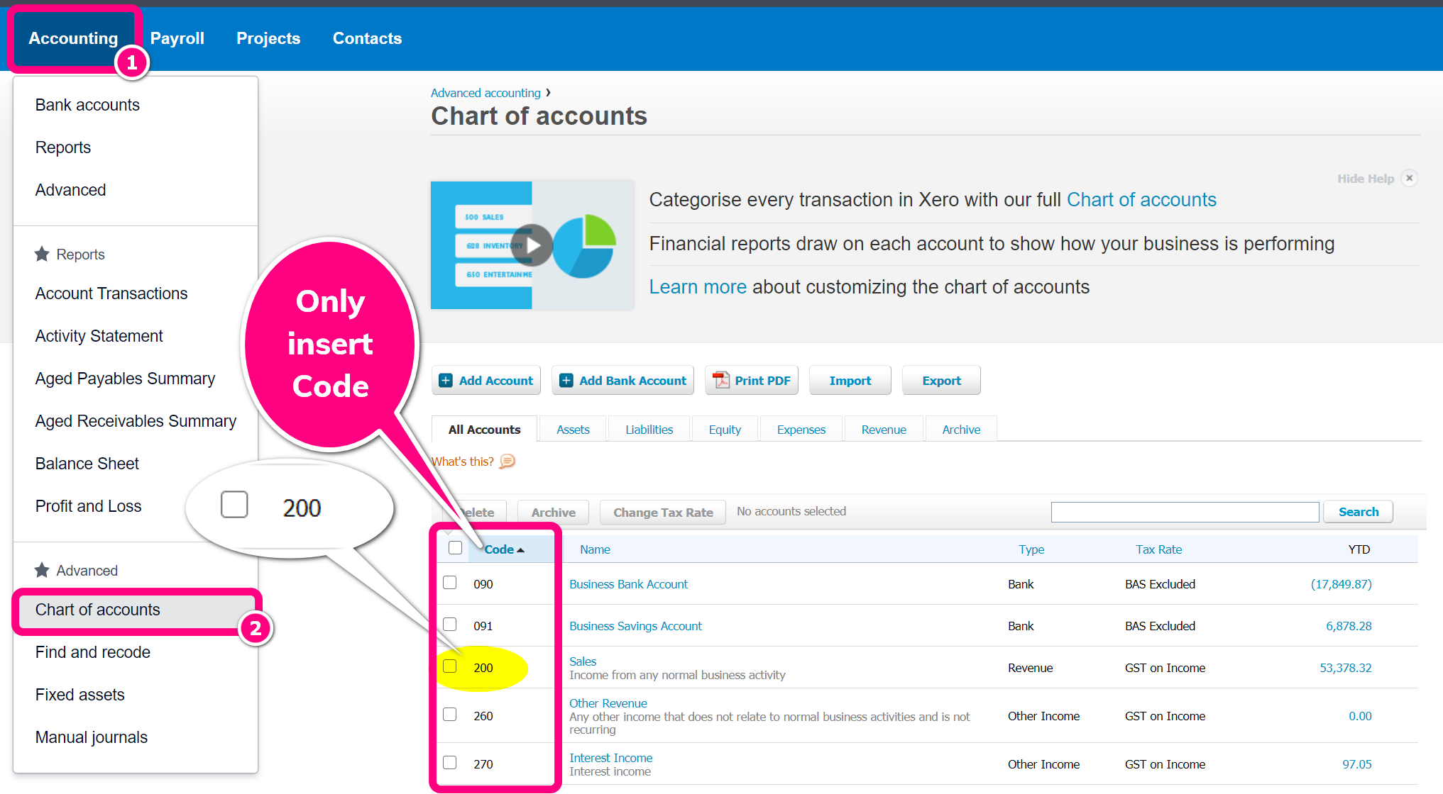

Ensure the 'Account Codes' Drop down is open. To Set a default Account Code for both Quotes/Client Invoices and Purchase Orders, you will only need to insert the CODE (eg. only 200 from 200 - Sales).
To find your list of Accounts go to your Xero Dashboard, then go Accounting > Chart of Accounts

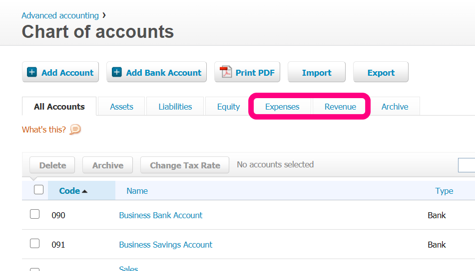

It is also important to add the right type of default account code for purchase orders and quotes/client invoices according to the Tax rate.
For Purchase orders, you should have an 'Expenses' Account as the values in a Purchase Order are costs to your business.
For Quotes/Client Invoices, you should use a 'Revenue' Account as the values in Quotes & Invoices is money you make.
You can sort your chart of account codes in Xero by clicking the 'Expenses' and 'Revenue' Category tabs.

How do I log out of Xero inside of PlusDesignBuild?
Simply open the Xero Tool and click "Disconnect from Xero"
