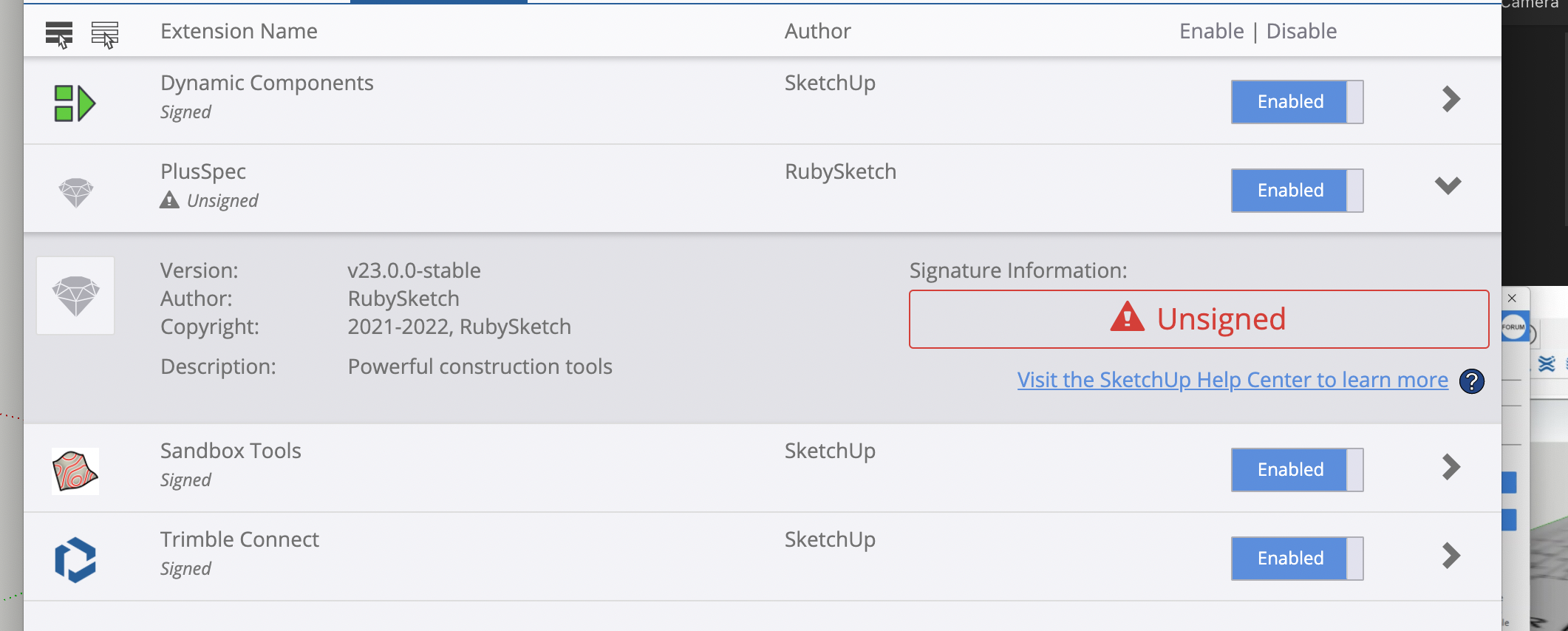

One of the most common causes for this "unsigned" issue is that you may have installed PlusSpec on another version of SketchUp. This can happen very easily but only takes a few minutes to install onto the correct version of Sketchup that you want to use. Also, the reason it appears as “unsigned” in the Extensions Manager is because only extensions from the SketchUp Extensions Warehouse are recognised as “signed”. This won’t affect the performance of PlusSpec.
Kindly refer to the instructions below. Please ensure you have downloaded PlusSpec correctly for your machine. Mac computers require an .RBZ file download, while Windows computers can download both .RBZ and .EXE files. The file type you have downloaded will change the installation process.
For SketchUp Versions 17 and Above
It is also possible that PlusSpec has not been installed correctly. To check this, open SketchUp, then click Window/SketchUp > Extension manager. Amongst this list on the page, PlusSpec should be visible and enabled. If PlusSpec is not enabled, please tick it.
For SketchUp Versions 16 and Below
It is also possible that PlusSpec has not been installed correctly. To check this, open SketchUp, then click Window/SketchUp > Preferences > Extensions. Amongst this drop-down list on the page, PlusSpec should be visible and ticked. If PlusSpec is not ticked, please tick it.
If PlusSpec is not visible, you will need to re-install PlusSpec. Click Here to go to the PlusSpec downloads page.
**If PlusSpec is not visible, you will need to re-install PlusSpec. Click Here to go to the PlusSpec downloads page.
