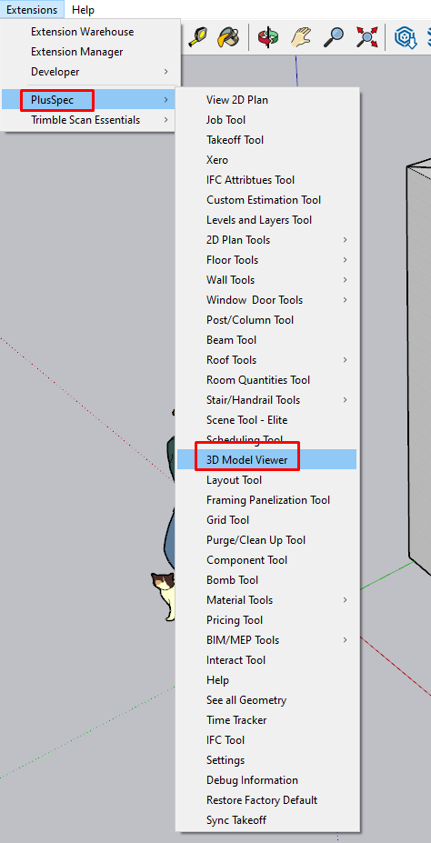

- Access the Model Viewer in the Extension >> PlusSpec >> Click 3D Model Viewer

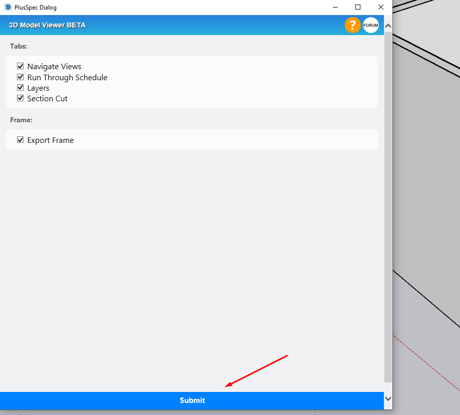

- Open the 3D Model Viewer Dialog >> Click Submit

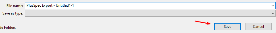

- Save the file to export.

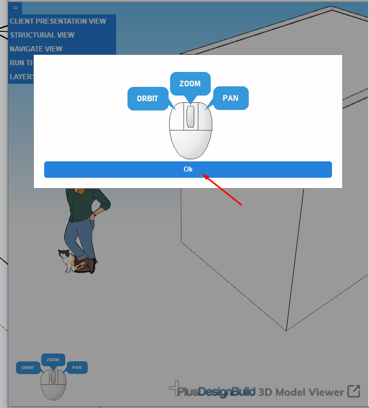

- Click OK to close the mouse navigation instruction.

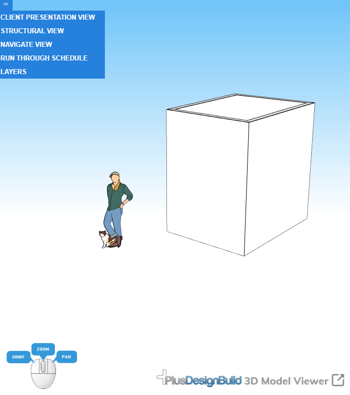

- Welcome to the 3D Model Viewer
