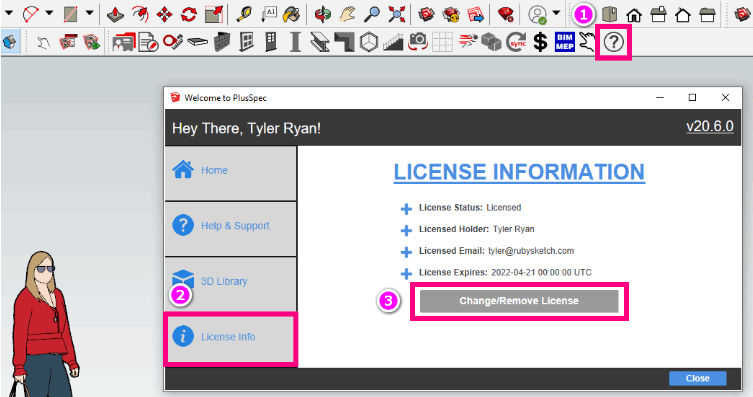

STEP 1 (on the current device where you are signed in)
- Open SketchUp where the PlusSpec software is currently installed.
- On the PlusSpec Welcome splash screen, click License info in the left column (alternatively, click on the (?) in the PlusSpec Toolbar and follow the order of the numbers in the image below)
- Click Change/Remove License > Yes
Close SketchUp

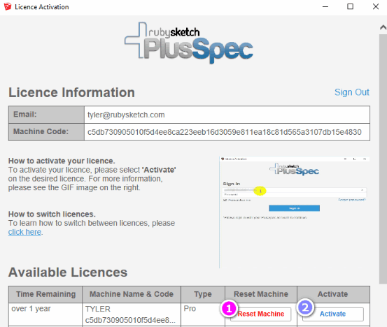

STEP 2 ( on the new device where you will be transferring the licence to) - On your preferred new device, open SketchUp (if you haven’t installed PlusSpec, you can download it |with your login details here)
- Sign in using your PlusSpec email address and password
- Click Reset Machine (Note: If you have multiple licences, it has to be the specific licence type from the previous computer)
- Then click Activate (same licence as step 7)
Close/Reopen SketchUp
