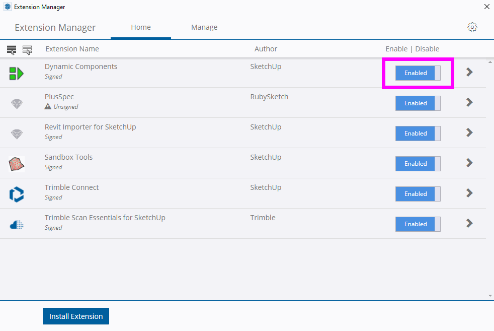

Here's how to resolve some issues related to installed extensions.
- Check if your Dynamic Components extension is enabled and up to date. If it's disabled, you may experience issues whilst drawing walls and windows/doors where the geometry appears incomplete.
2. Sometimes, third-party extensions can cause conflicts. Disable all extensions except for PlusSpec and the native SketchUp extensions (refer to the image above), then check if the issue still persists after closing and relaunching SketchUp.
