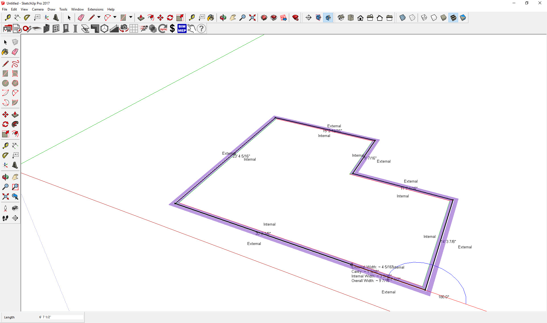

When drawing a wall using the wall tool, it will not complete it's loop. It just leaves a purple/pink outline.
Solutions
As silly as it sounds, when you complete your wall outline make sure you double-click with your mouse to complete the draw.

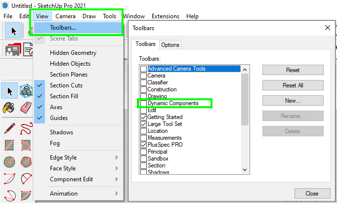

In SketchUp go to View > Toolbars > and ensure Dynamic Components are checked.
