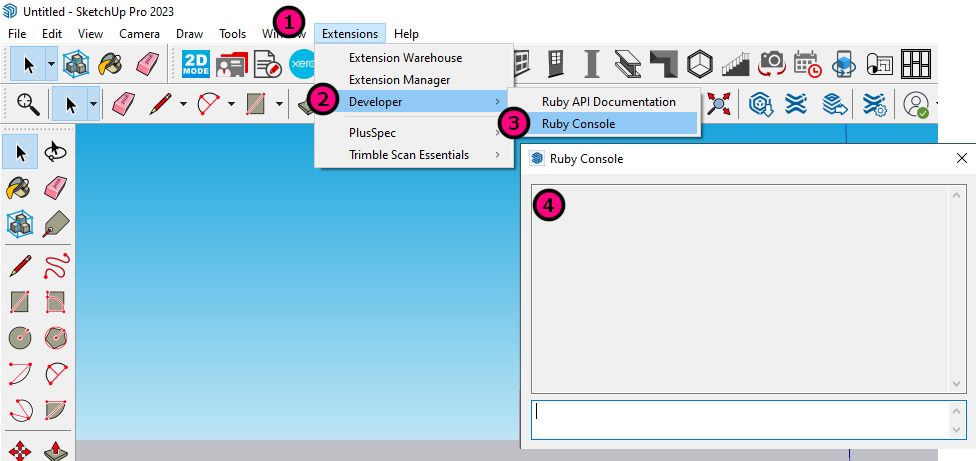

When the PlusSpec or PlusDesignBuild toolbar does not appear in your SketchUp, follow this step to fix the issue.
Open the Ruby Console by clicking Extensions > Developer > Ruby Console. And then paste the script below:
