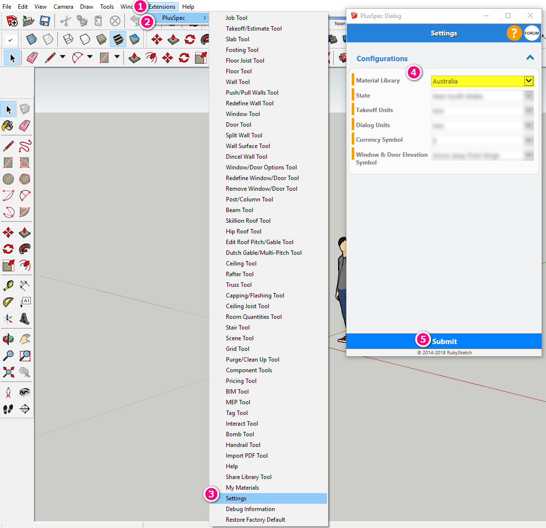

1. Please click on Extensions > PlusSpec > Settings > change the material library to another country > Press submit.

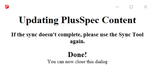

Wait for the software to update you will see a series of question marks populate your screen.
The materials will update, and you will see the screen below once the sync is complete.
3. Repeat the first step (1), but change the country back to your desired material library and press submit. Then wait for the materials to sync again (as in step 2).
